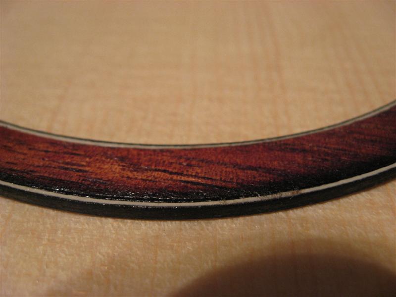

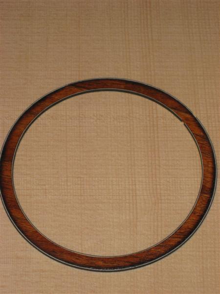

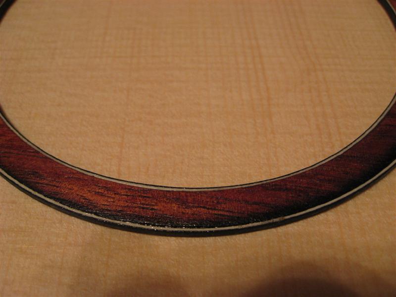

Thought I'd share a new rosette I'm trying out for a guitar I'm building for a friend. It is a new technique I learned from Michael Bashkin of bashkinguitars.com. Can anyone guess the method for getting this sunburst look on this rosette? It is Koa with a light coat of shellac on it.

Very good Dean, it is hot sand! Rolling it through hot sand vertically does this. You can increase the flame on the rosette by adding more sand so it covers more of the rosette as you roll it through. Very cool technique. I'll be doing this on the Koa endwedge also to give it a matching affect. Thanks for all the nice comments!

James, the hot sand technique just means to get about 1 cup of sand from wherever, and put it in a pan. Heat it up over the stove until it is extremely hot. Then roll the rosette in the hot sand until cooked, I mean done. Just wear some cloth gloves so your hands don't burn. Does that explain? I like your idea of a rosette. Maybe mahogany or Eucalyptus may work for you?

The only problems i've ever had with the hot sand technique is that it drains 100% of moisture out of the wood. your rosette (or other inlay)  may be smaller from shrinkage as a result.

Is this color just on the surface? How far does it go into the wood? Meaning if you leave the rosette proud of the top and then sand it does it sand off?

Thanks guys! Brock, very cool idea on how to sunburst a whole guitar using this method. You could just create a 20" x 20" sand pit and put some propane burners under it. Then just burn the sides to the depth you want. the burn does go all the way through the wood, so if you sand it, it does not sand off. However, it will sand off in areas that are further in because it is not burned all the way through. Not sure it will work for bursting a whole guitar. I would inlay the rosette slightly lower than flush, then sand down to the rosette and stop as soon as you touch the rosette. I haven't inlayed this rosette yet, but I will put in in a test top first. I'll let you know how it turns out.

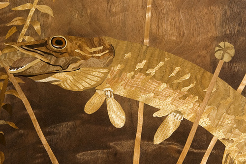

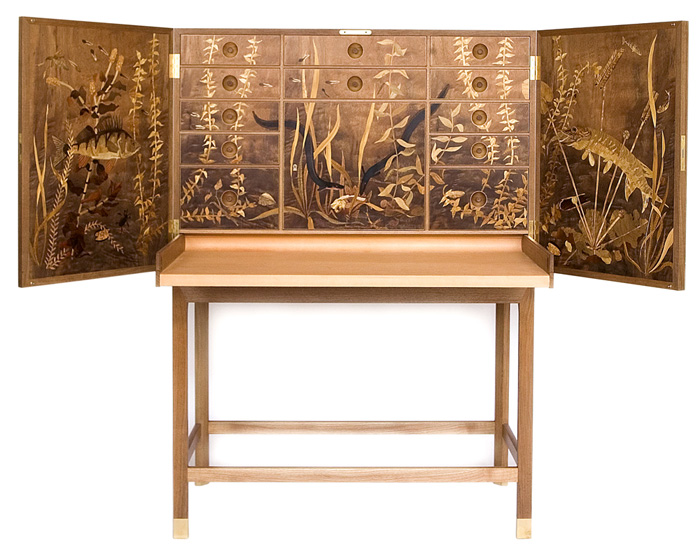

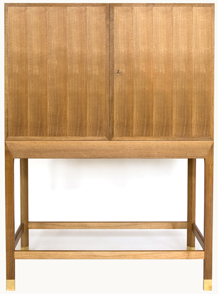

Nice looking rosette! The sand technique is very common in marquetry, a guy at the education I was in did this cabinet using the technique A LOT! Just thought id show these pics...
What can you say, 1050(!) hours!! His website: http://kjetilharket.no/en/
